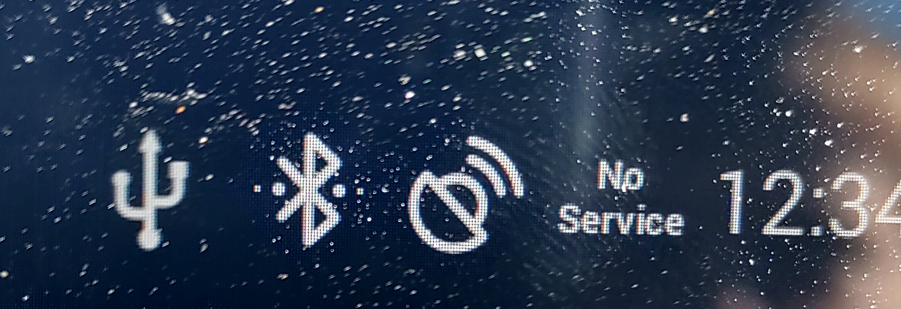

No 4G connection in car, no app connection
Zitat von ch4071cslayer am 20. März 2022, 12:27 UhrFor the last 3 days I haven't had any connection to my U5 on my app. I noticed that there was also no 4G connection in my car.
Does anyone know how to fix this? And is this a problem for anyone else?
Thanks.
Thanks.
